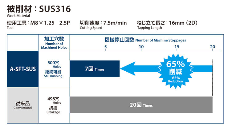

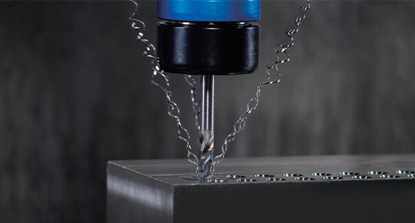

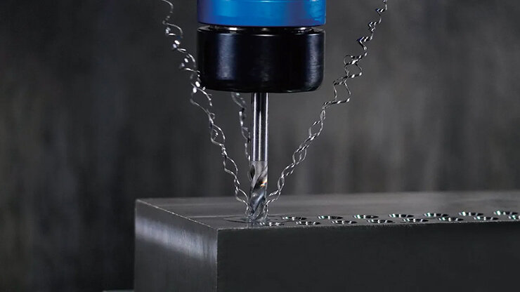

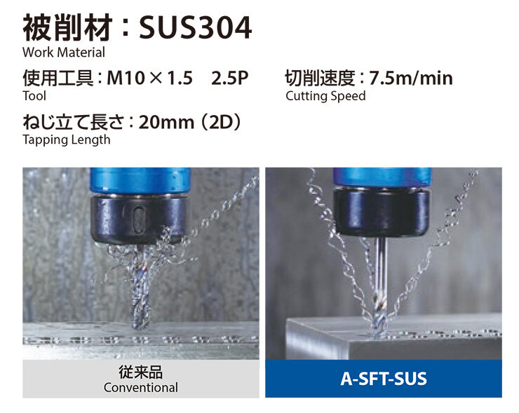

The biggest factor that reduces tapping efficiency is chip entanglement. This is especially problematic when machining stainless steel, where tough, ductile chips are difficult to evacuate and tend to cause instability. The A SFT SUS suppresses chip entanglement in stainless steel tapping and improves work efficiency by reducing machine downtime associated with chip removal. Fewer machine stops boost productivity, reduce labor needs, and help lower power consumption. This spiral flute tap is highly recommended for stainless steel applications where chip entanglement is a concern.

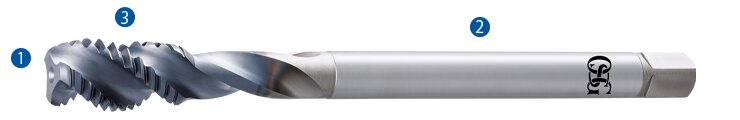

Spiral Flute Tap for Stainless Steel Features

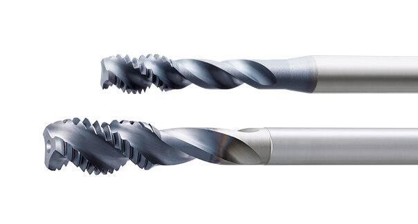

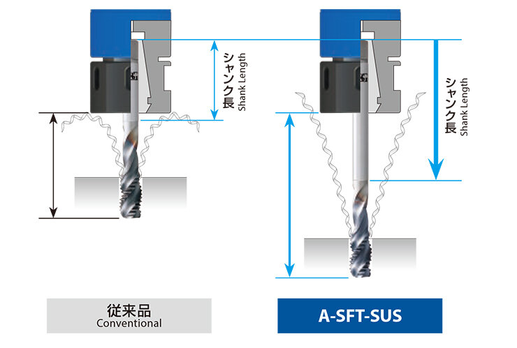

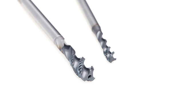

1 Flute geometry optimized for stainless steel delivers smooth chip evacuation
2 Optimal shank length that suppresses chip entanglement Optimal shank length that suppresses chip entanglement
3 VI coating dedicated to high-performance taps

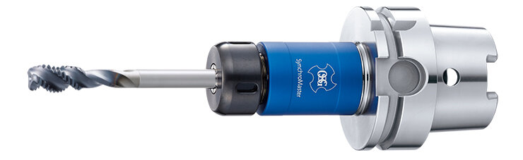

  • New generation synchronized tap holder designed to maximize the performance of your A-SFT-SUS.

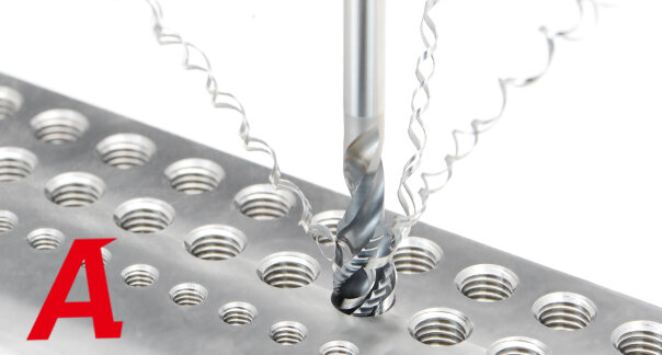

Smooth chip evacuation for better operational efficiency
Environmental Considerations
Reducing machine stoppages increases productivity and reduces power consumption
