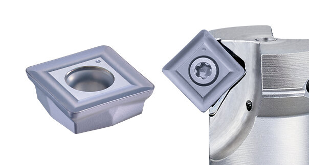

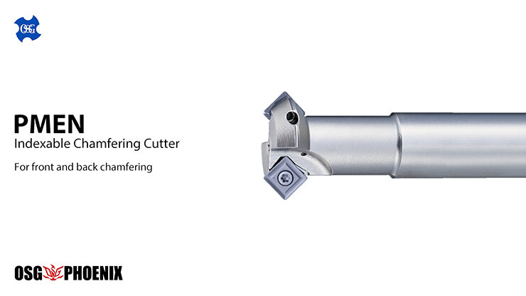

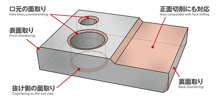

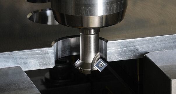

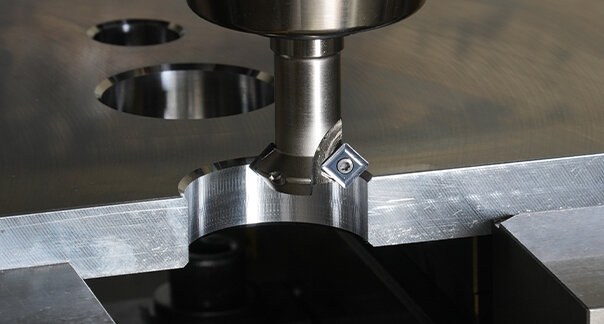

The PMEN indexable chamfering cutter is a chamfering cutter that can perform both front and back chamfering. Chamfering of 30°, 45°, and 60° is possible with a common insert and two types of bodies. The body shape allows the user to visually check the set chamfer angle to prevent machining errors.
Chamfering cutter capable of front and back chamfering

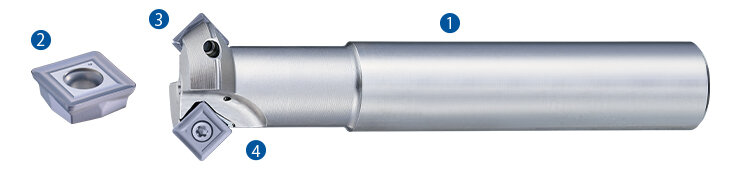

Chamfering Cutter Features
1 2 types of body
  • Body compatible with chamfer angles of 45° and 30°
  • Body compatible with chamfer angles of 45° and 60°
  • 2 Insert that allows two types of chamfer angles

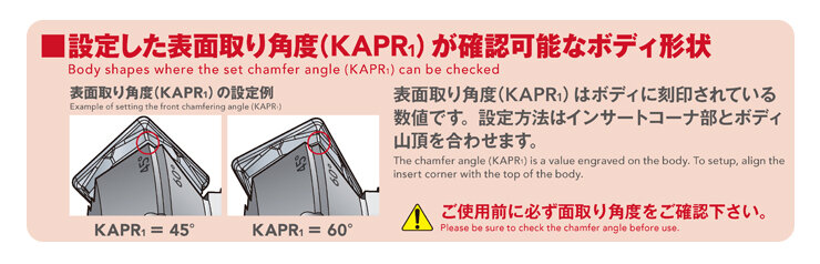

    3 Body shape that allows the user to confirm the set chamfer angle at a glance
    4 Internal coolant for stable machining

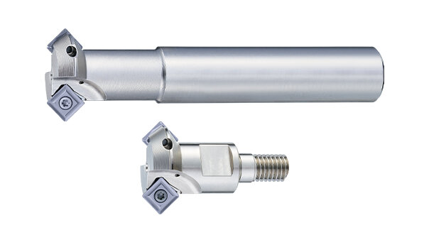

    Straight Shank Type, Screw Fit Type
    • Chamfer angle 45°, 30° φ8.5~φ32.5
    • Chamfer angle 45°, 60° φ8.5~φ32.5

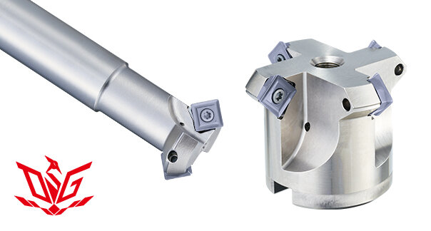

    Bore Type
    • Chamfer angle 45°, 30° φ40.5~φ60.5
    • Chamfer angle 45°, 60° φ40.5~φ60.5

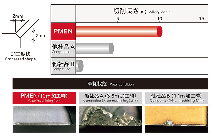

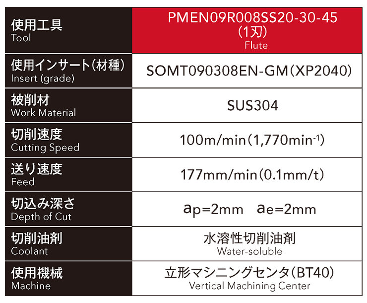

    Achieves greater durability versus the competitor tools in SUS304 chamfering
chamfering
chamfering
