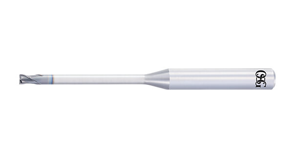

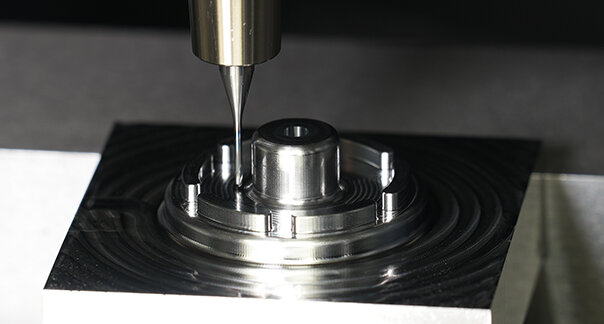

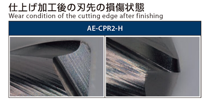

The AE-CPR2-H is a 2-flute long-neck radius carbide end mill optimized for high precision finishing of high-hardness materials. Since the number of cutting edges cutting simultaneously is small, tool deflection is suppressed with low resistance, enabling high-quality processing. The corner radius is designed with a 3-dimensional negative geometry that combines both sharpness and cutting edge rigidity. Furthermore, with the addition of OSG’s “DUROREY” coating optimized for high-hardness steel, high chipping resistance is achieved even in workpieces of over 60 HRC, enabling long tool life and high-precision machining.

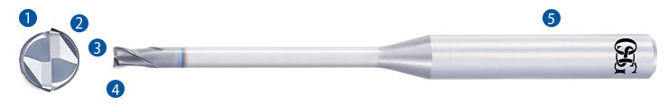

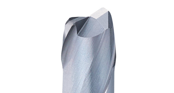

2-flute high-precision finishing long neck carbide radius end mill for high-hardness steel Features
  • DUROREY coating enables superior heat resistance and high toughness optimized for high-hardness steel milling!

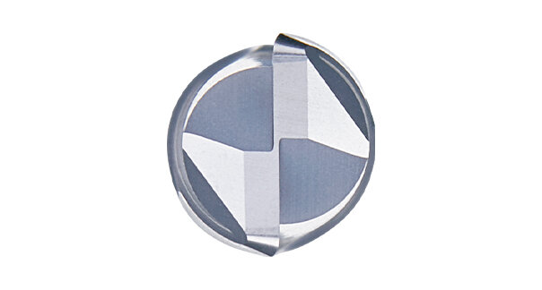

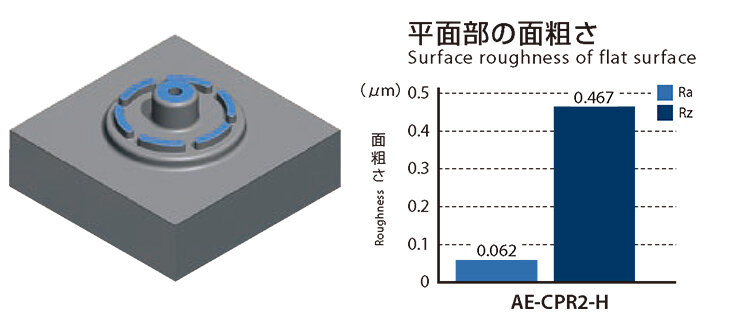

1 Low resistance by 2-flute specification
2 Achieves both sharpness and cutting edge rigidity by three-dimensional negative geometry
3 Higher precision machined surface quality by flat cutting edge specification ※Excluding some sizes
4 Superior ball corner R precision
5 Superior shank accuracy. Supports h4 tolerance (0/-0.004)

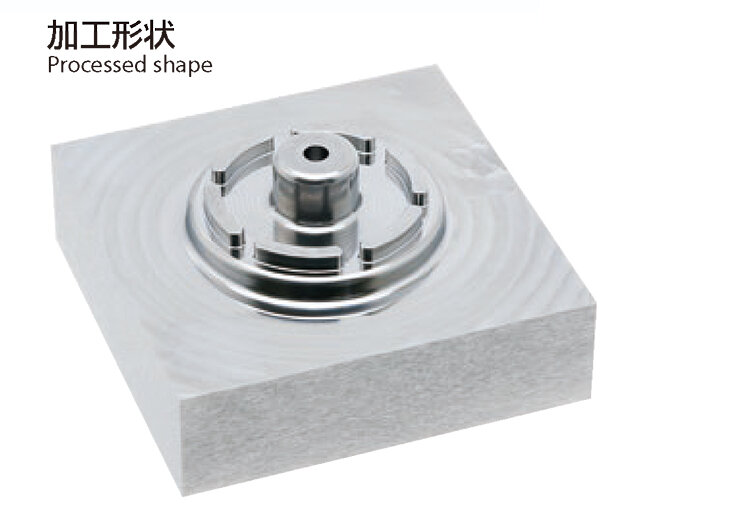

High-quality finishing
