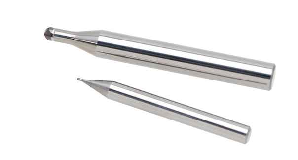

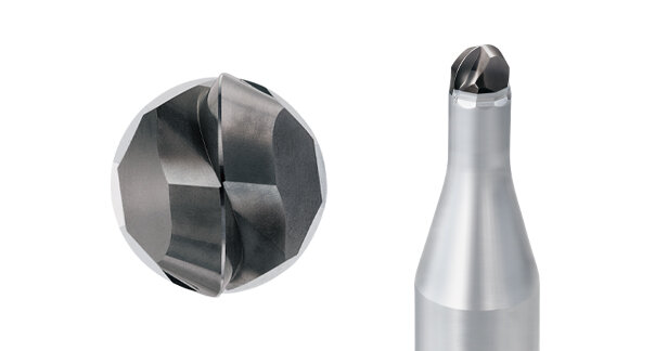

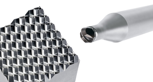

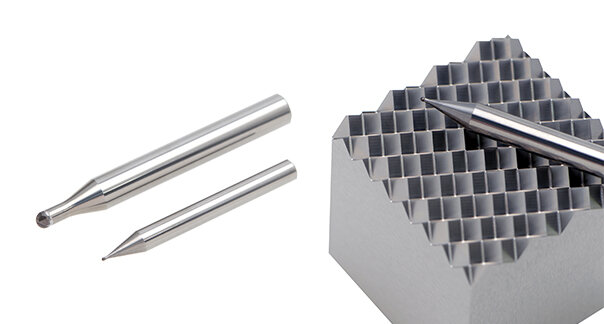

Mold materials have grown increasingly harder in recent years, driving demand for greater machining precision. The CBN-FB2 features a CBN sintered body with superior wear and heat resistance, ensuring consistent accuracy over extended use. This minimizes changes in precision caused by tool replacement during processing. In addition, reducing machine downtime associated with tool changes significantly shortens the overall lead time for mold manufacturing.

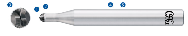

2-flute CBN Ball End Mill Features
1 CBN sintered body with superior wear and heat resistance
2 Superior ball R precision of ±0.003
3 Microrelief that suppresses shape deformation caused by wear
4 High-accuracy shank of -0.001 to -0.003
5 Shank length designed for optimal protrusion

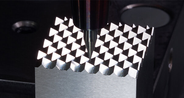

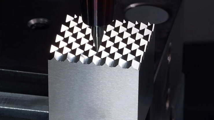

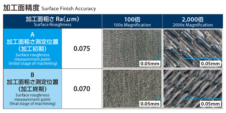

High-quality surface finish even during extended machining

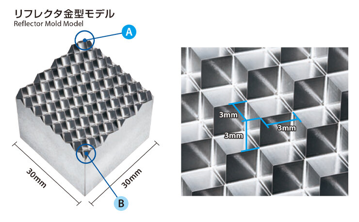

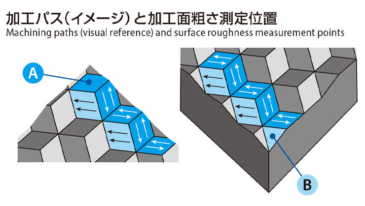

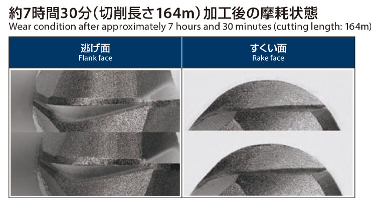

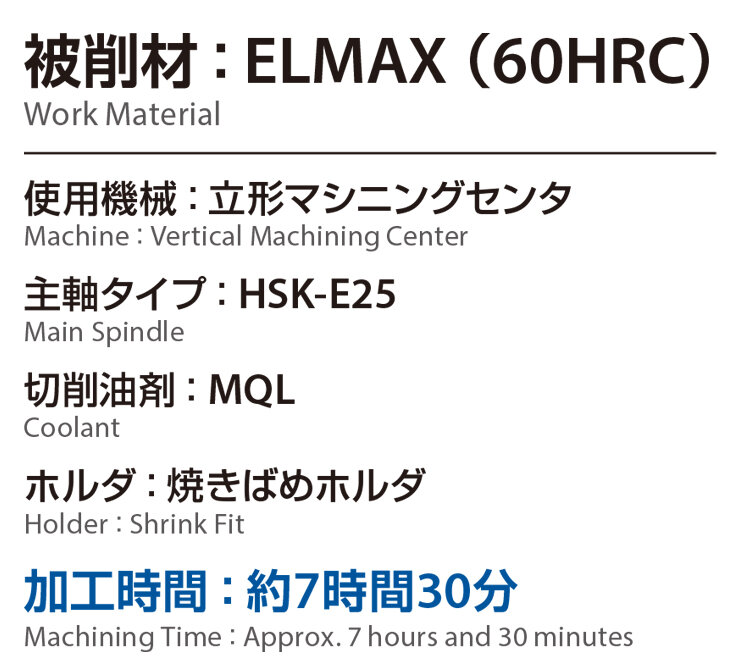

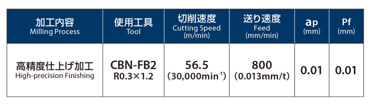

Excellent surface finish maintained even after approximately 7 hours and 30 minutes of machining
長High-quality surface finish even during extended machining
