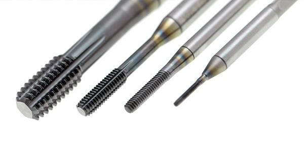

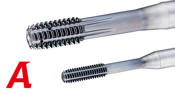

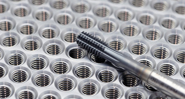

Most tapping troubles are caused by unstable chip evacuation. The A-XPF forms threads by plastic deformation of the work material and does not generate cutting chips. The A-XPF enables the reduction of tool change time caused by cutting chip troubles and machine downtime required for removing accumulated cutting chips. Furthermore, by enabling stable and uninterrupted machining, power consumption can be reduced, which minimizes environmental impact. Large diameter sizes of M18 to M24 can also accommodate the machining of large components. Moreover, short chamfer type (length of chamfer: 1P) M1 to M6 are ideal for the machining of small precision parts that are becoming thinner and lighter with little room for pre-hole. The newly added A-OIL-XPF with internal coolant holes is compatible with mist machining. Mist coolant cutting eliminates the need for oil disposal, which helps reduce waste. Furthermore, there is less scattering of cutting oil, which also leads to an improved work environment.

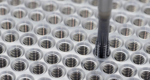

Improves productivity with zero cutting chips.

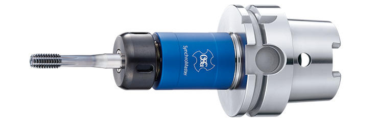

- New generation synchronized tap holder designed to maximize the performance of your A-XPF tools

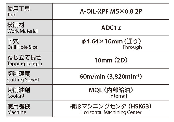

With internal coolant holes
M5~M16

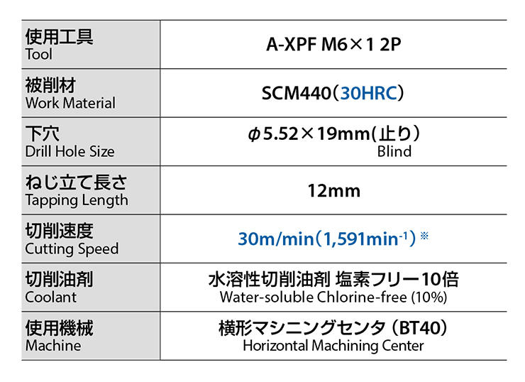

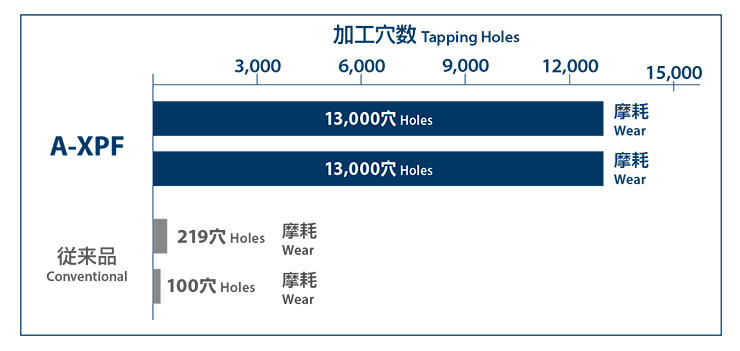

Achieves cutting speed of 30m/min in high-hardness material
Achieves high-speed and stable machining in SCM440(30 HRC)
※For testing purposes, the conventional product was also used under high-speed cutting condition.

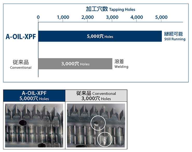

Compatible with mist coolant processing to reduce waste
Mist coolant cutting eliminates the need for waste oil disposal, which helps reduce waste. Furthermore, there is less scattering of cutting oil, which also leads to an improved work environment.
