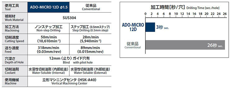

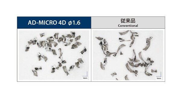

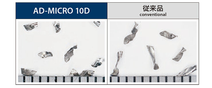

Problems in small diameter hole machining predominantly stem from unstable chip evacuation. AD-MICRO addresses this issue with cutting edge specifications and flute geometry optimized for small diameter applications, enabling the formation of stable chip shapes—even with external coolant—and ensuring reliable uninterrupted machining. ADO-MICRO’s unique oil holes and flute geometry enable stable and high efficiency processing in small diameter deep-hole applications. Non-step drilling is made possible even for deep-hole applications, with approximately 9 times the machining efficiency versus step drilling. The AD-MICRO series is now available in a new 7D type, complementing the existing 4D and 10D offerings.
Small Diameter Carbide Drills Features

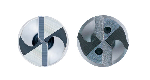

  • Cutting edge specifications optimized for small diameter holes
  • Unique flute geometry that enables outstanding chip evacuation performance
  • Optimal coating for drill specifications
AD-MICRO: KeptA Coating
ADO-MICRO: IchAda Coating

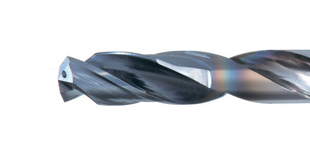

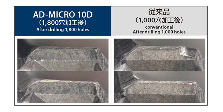

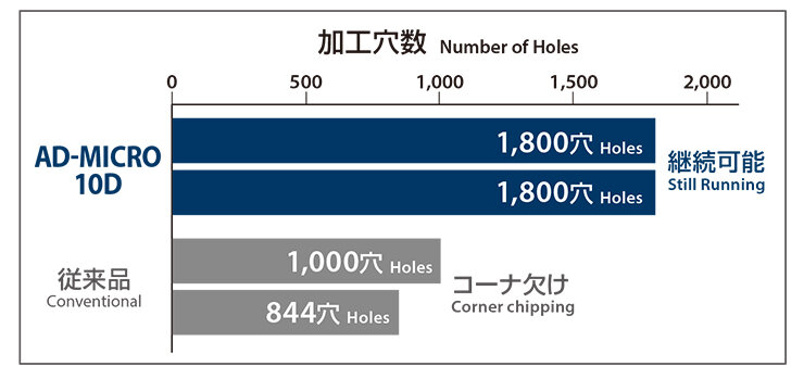

1 AD-MICRO: Should Edge Guard (SEG) prevents chipping of peripheral corners (applicable to sizes over φ2)

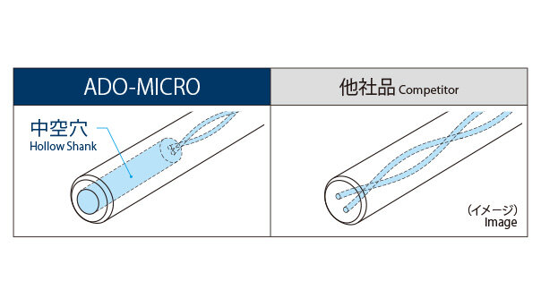

2 ADO-MICRO:Large oil holes and hollow shank design to allow greater coolant flow volume
3 ADO-MICRO:Double margin configuration that supports the straightness stability of the tool

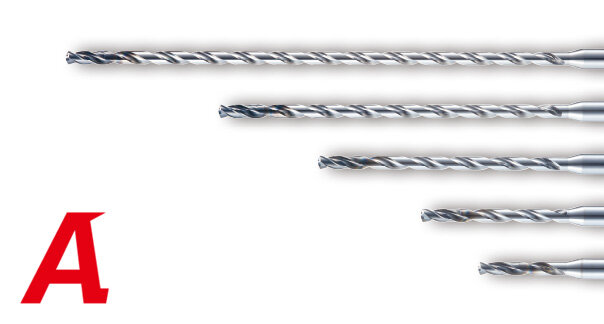

Small diameter carbide drill
  • AD-MICRO 4D φ0.5~3
  • AD-MICRO 7D φ0.5~3
  • AD-MICRO 10D φ0.5~φ3
Small diameter carbide drill with oil holes
  • ADO-MICRO 2D φ0.7~φ2
  • ADO-MICRO 5D φ0.7~φ2
Small diameter carbide drill with oil holes – Long type
  • ADO-MICRO 12D φ1~φ2
  • ADO-MICRO 20D φ1~φ2
  • ADO-MICRO 30D φ1~φ2
Approximately 9 times the drilling efficiency by non-step drilling
